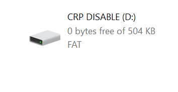

One question: The firmware.bin file is displayed as having a filesize of 504kB (always) even though I had previously flashed the blinky.bin which is only 32kB.   Is that expected?

Hello @perdrix
" Is that expected?"
->>Yes, the same on my side.

There does appear to be an oddity.   Regardless of the image size if download into the board using the bootloader, when it starts it always shows a file firmware.bin of 504kb (not 512kB) not the size of the image I last loaded ...  Is that expected?

I tested it on my side, the usb bootloader can work well with win11.
Please test directly program the bootloader.hex file, not build by yourself, and before program, full erase the chip. Then power-up again.
There should be a disk under my computer:
In Device manager, there is USB Mass Storage Device:
If still can not work, please check jumpers on your board refer to <AN10866>.
