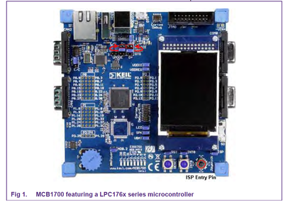

I built the sample Secondary USB Bootloader application (no changes) for the MCB1700 board and flashed the bootloader to the board.
I connected the board to my Windows 11 system (using the USB-B connector on the board).  Held down the joystick button and pressed RESET.
Windows "This PC" shows a USB device but nothing is shown as being mounted.
So what did I do wrong?   The joystick switch works OK and the earthy side of the switch measures 100 ohms (R81) to ground.

perdrix
Many thanks for checking that for me.
I tested with the prebuilt version after unzipping the file again.  That worked.  Rebuilding the project in uVision 5 and flashing it also worked, so I must have accidentally changed something while exploring the code.  My apologies for the error.
One question: The firmware.bin file is displayed as having a filesize of 504kB (always) even though I had previously flashed the blinky.bin which is only 32kB.   Is that expected?

Hello @perdrix
I tested it on my side, the usb bootloader can work well with win11.
Please test directly program the bootloader.hex file, not build by yourself, and before program, full erase the chip. Then power-up again.
There should be a disk under my computer:
In Device manager, there is USB Mass Storage Device:
If still can not work, please check jumpers on your board refer to <AN10866>.
