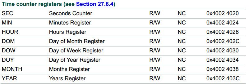

jeremyzhou
Hi Abhinav,
I didn't find that you initialize the set of Time counter registers (Fig 1) in your demo, and I think it's the root cause of the issue.
So I'd highly recommend you to refer to the rtc demo in the LPCxpresso_1769's sample demo whose downloading link is below.
I've also attached some codes which is used to configure the set of Time counter registers.
Fig 1
    /* Set current time for RTC 2:00:00PM, 2012-10-05 */
    FullTime.time[RTC_TIMETYPE_SECOND]  = 0;
    FullTime.time[RTC_TIMETYPE_MINUTE]  = 0;
    FullTime.time[RTC_TIMETYPE_HOUR]    = 14;
    FullTime.time[RTC_TIMETYPE_DAYOFMONTH]  = 5;
    FullTime.time[RTC_TIMETYPE_DAYOFWEEK]   = 5;
    FullTime.time[RTC_TIMETYPE_DAYOFYEAR]   = 279;
    FullTime.time[RTC_TIMETYPE_MONTH]   = 10;
    FullTime.time[RTC_TIMETYPE_YEAR]    = 2012;
    Chip_RTC_SetFullTime(LPC_RTC, &FullTime);
