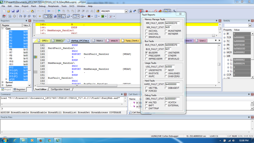

prasanthapplied
Thanks for your reply Con Verse. I debug my code and got the cause of hard fault. But i don't have an idea to solve that. I attached a screenshot to it.
Hard fault gets occur due to instruction bus error. Please help me to solve this.
This hard fault gets occur while using an external interrupt pins else code works fine. Is have any relation between them?

carstengroen
Senior Contributor II
Use the link I gave you to gain the knowledge to find whats going on. Hint, check LR register, find out what instruction (address) that caused the hardfault in the first place. Possibly something in your EINT3 IRQ handler ??

prasanthapplied
Dear Groen,
               LR register indicating address is 0xFFFFFFF9. How to i find the instruction using this address? If i put this address to memory window it gives a message of "cannot access memory". What i want to do?
            If a problem occur due to EINT3 IRQ Handler what modification i want to do to solve that?

prasanthapplied
Dear Mendoza,
                   Thank you very much for your response. I got that example programs any verified my code with that. Now i find the cause of that hard fault handler. Actually the problem is my program logic. What i did is while occurring an external interrupt update some variables to call the function. But i didn't properly get out from the currently running function. So when i give an external interrupt continuously program gets hang with a hard fault handler.
           Now i alter my code to whenever getting an interrupt get out from a currently running function and then proceed corresponding interrupt process. It works fine.
