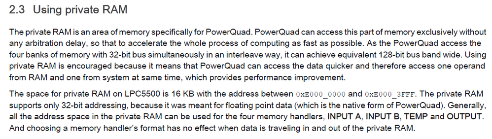

I use PowerQuad private RAM in LPCXpresso55S69 development board to accelerate computation.
From documentation PowerQuad private RAM has size of 16kB, but I have problem with addressing upper half. It seems that data from lower half of private RAM are overwritten if upper half are used.
I add sample project when write to upper half of private RAM causes that data is overwritten. When there is no call to upper half, example works OK.

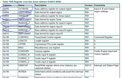

I think there are four base address, which define the memory allocation OUTBASE,INABASE, INBBASE,TMPBASE, they are configured by application code explicitly, but they can not be overlapped, in the PQ_GetDefaultConfig(), the TMPBASE is set up in 0xE000_0000, so user can not use the space.
Hope it can help you
Xiangjun Rong

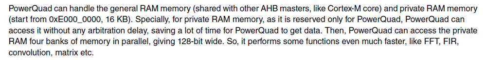

The AE team said that the address space 0xE000_0000 to 0xE000_3FFF are shared the same memory cell with SRAM4 0x2004_0000 to 0x2004_3FFF, pls check if you use the SRAM4
Xiangjun Rong
5,791件の閲覧回数
xiangjun_rong

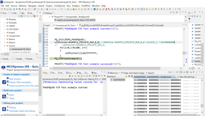

I have tried to fill the private memory from 0xE000_0000 to 0xE000_3FFF with 0xFFFF_FFFF, after the operation is over, then read the private memory, I can not read them correctly.
If I fill the SRAM4, I can write and read correctly.
In conclusion, the private memory can not be used to save application data.
In the an12383, the private memory from 0xE000_0000 to 0xE000_3FFF are used for temporary only and it is assigned to PowerQuad->TMPBASE register.
BTW, the private memory is  mentioned in neither reference manual not data sheet. Pls do not use the memory unless it is  ussed as TMPBASE.

1. PowerQuad is mapping private memory from 0xE000_0000 to 0xE000_3FFF address space to SRAM4 0x2004_0000 to 0x2004_3FFF address space and use SRAM in interleave way. I checked that data is correctly saved in SRAM4. I add screenshots below.
If you try to use memory from 0xE000_0000 to 0xE000_3FFF address space from ARM you use different peripheral.
PQ_memory_1.pngPQ_memory_1.pngPQ_memory_2.pngPQ_memory_2.pngPQ_memory_3.pngPQ_memory_3.pngPQ_memory_4.pngPQ_memory_4.png
2. I add project which points whats the problem and work correctly.
3. https://community.nxp.com/t5/LPC-Microcontrollers/Use-Powerquad-Private-RAM/td-p/1069956 points that: "We have powerquad_fir_fast SDK demo include powerquad private ram operation that we recommend. Please check it." Than I can I use this memory as pointed by other answer. I use exactly matrix scale operation to access private PowerQuad RAM.
4. Whats the point of articles like https://community.nxp.com/pwmxy87654/attachments/pwmxy87654/tech-days/319/1/AMF-SMH-T3513_Hands-on_3... this is LAB from NXP that FIR with USE of the PRIVATE RAM is faster.
EDIT:
- This LAB from NXP points that private RAM can be used for improve FIR, convolve, corelate opertation. They explicit points that placing the input data B. Private RAM can be used not only for TMPBASE.
5. I add many application notes like https://www.nxp.com/docs/en/application-note/AN12383.pdf or https://www.nxp.com/docs/en/application-note/AN12282.pdf that points that private RAM of PowerQuad could be used by user. What the point of share this information if this should be not used by user?

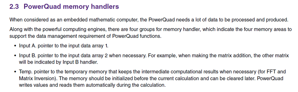

Also AN12282 and AN12383 points that TMPBASE is used only for FFT or Matrix Inversion.
I don't use any of this operation. Then TEMP area should not be used.
