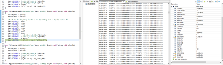

Before the PQ call, here’s what things look like (everything seems to be configured correctly in the PQ registers). Memory at 0x20018000 is fine.
Immediately after the PQ call there is a 256-long word block overwritten at 0x20018000.

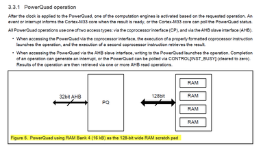

Secondly, based on reference manual, the SRAM4(0x2004_0000~0x2004_3FFF) are used by PowerQuad module.

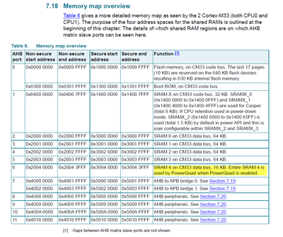

For the LPC55S36 or LPC5536, it uses the SRAM4.
The SRAM4 is located at the address from 0x2001_8000 to 0x2001_BFFF.

I now see the entry in the datasheet that indicates that SRAM 4 (0x20018000-0x2001c000) is for PowerQuad use. That brings up three issues:
1) That fact is virtually hidden among hundreds of pages of documents, and is completely unmentioned in the App Notes. Not good.

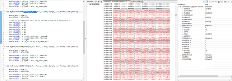

3) FInally, I don't think that it is actually true that the PQ uses SRAM 4 at all. I reduced some data structures in my code and moved the stack to the "end of data" such that SRAM 4 is completely unused. I filled all of SRAM 4 with 0xA5. Then I ran our code, while pointing the tmpbase register to a pre-allocated buffer like this:

This code executes flawlessly, the PQ uses the fftTmpBuf as is scratchpad, and SRAM 4 is *undisturbed* over dozens and dozens of PQ calls (including PQ_MatrixScale, PQ_MatrixAddition, PQ_MatrixProduct, PQ_MatrixMultiplication as well as PQ_TransformRFFT)
