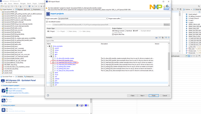

The LPC55S06 has SDK package, after you get the I2C port and pins, you can use the I2C example as the following fig, then modify the pin_mux.c to change the pins of I2C, and change the I2C port in *_master.c with the code like:
#define EXAMPLE_I2C_MASTER_BASE (I2C3_BASE)
