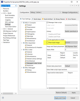

The LPC54S018J4M MCU has 192K SRAMX and 4MB spifi flash. Is the maximum plain load image size restricted by the size of the SRAMX, i.e. 192K for LPC54S018J4M?

Hello Rex,
This is depends on how config in your IDE or linker file, for example MCUXpresso IDE, when do NOT enable "Plain load image",
it will flash XIP.
You can open the demos "hello world" and "hello world xip" under SDK  to check the difference.

rex_lam
Hi Alice,
Let's assume that I want to enable "plain load image". Is the maximum firmware image size then restricted to 192K?
Rex
3,638 Views
YES.

Hello rex_lam,
No, you can directly  Execute in place from spifi flash.

rex_lam
Alice,
Thank you for responding. To clarify, do you mean that the first 192K will execute from SRAMX and the higher addresses of the firmware image will execute in place from spifi flash? Is this the default behavior for plain load image?
