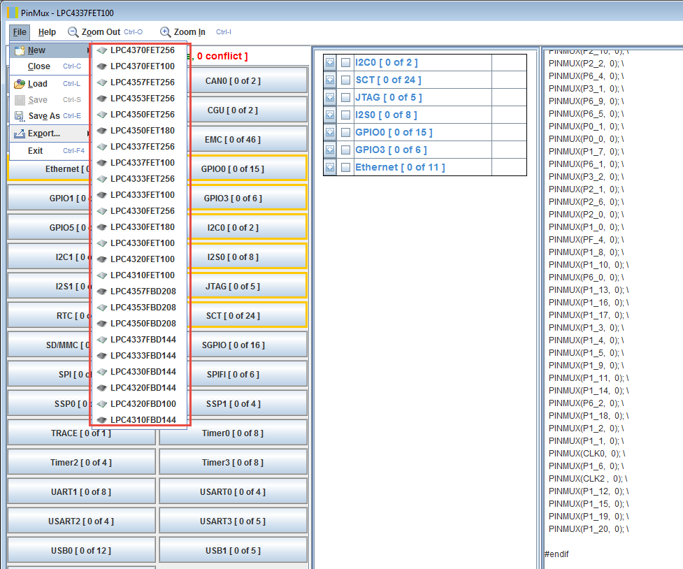

Hi:
I came across several pinmux tool from NPX
However they are not for LPC43xx. Is there an official one? Thanks.

HI HM Yoong,
   There still don't have the direct official LPC43xx pinmux tool now, we also recommend you use the
A 3rd party LPC43xx Pinmux tool
    This Pinmux tool is for the LC43XX, you can try it.

hmyoong
Hi:
  Pin information from the software is correct but is not complete.  The diagram below show SSP0 and SSP1 functions from LPC4370FET100 package.
From the datasheet, for example, SSP1_MISO is available not only in P0_0 but also P1_3. Do I miss out anything?

torbjoerntvermo
I don't believe there is a official pin tool but that should not be necessary as the 3'rd one you list from IKVM.NET covers LPC43xx and works quite well. Have you tried it?
