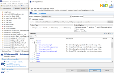

I configured PWM pulse port-1 pin-4 its working ,but,
when i try to generate PWM pulse in port-0 pin-31 its NOT working.
please update me if any changes to my below configuration

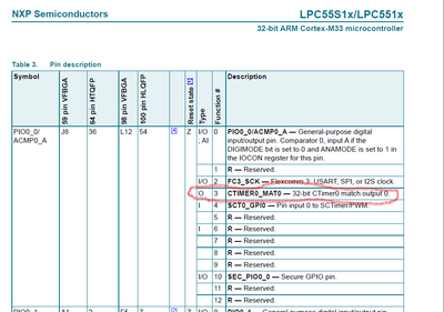

xiangjun_rong
First of all, pls download data sheet of lpc5516 and check it in pin description. For example, the PIO0-0 can function as CTIMER0_MAT0, which means that the pin can function to output PWM signal.
PIO0_3 CTIMER0_MAT1
PIO0_5 CTIMER3_MAT0
PIO0_10 CTIMER2_MAT0
In conclusion, all the CTIMERx_MATy pin can function as CTIMER PWM signal. In general, the MATCH0 register is used to configure the PWM period, so the CATIMERx_MAT0 is not used to output PWM. Of course, if you use the other match reg to control period, the MAT0 can be used to output PWM.
2)The SDK has example to have the CTIMER output PWM signal
In the ctimer_PWM example, the PWM signal can output from PIO1_4 pin which multiplexed with CTIMER2_MAT1.
The example uses CTIMER2 MAT2, we use the follow Macro
#define CTIMER CTIMER2 /* Timer 2 */
#define CTIMER_MAT_OUT kCTIMER_Match_1 /* Match output 1 */
In the pin_mux.c file, the following is defined:
const uint32_t port1_pin4_config = (/* Pin is configured as CTIMER2_MAT1 */
IOCON_PIO_FUNC3 |
/* No addition pin function */
IOCON_PIO_MODE_INACT |
/* Standard mode, output slew rate control is enabled */
IOCON_PIO_SLEW_STANDARD |
/* Input function is not inverted */
IOCON_PIO_INV_DI |
/* Enables digital function */
IOCON_PIO_DIGITAL_EN |
/* Open drain is disabled */
IOCON_PIO_OPENDRAIN_DI);
/* PORT1 PIN4 (coords: 1) is configured as CTIMER2_MAT1 */
IOCON_PinMuxSet(IOCON, 1U, 4U, port1_pin4_config);
