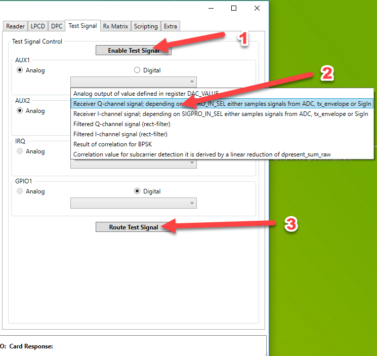

Kan_Li
Hi @charlie3222112 ,
Actually there is no need to write EEPROM@0x17 manually, the Cockpit tool can do it as shown below:
With step 1, testbus is enabled, and you may select analog signals routed to AUX1/2 pins, after step 3, the signals can be probed on AUX1/2 pins. You may refer to https://www.nxp.com.cn/docs/en/application-note/AN11740.pdf for more details on the test cases with these signals.
Hope that helps,
Kan

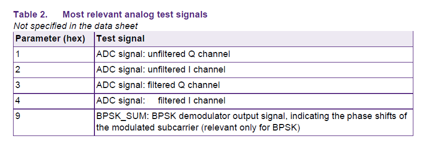

These definitions are for CLRC663 , for PN5180, please kindly refer to AN11740. https://www.nxp.com.cn/docs/en/application-note/AN11740.pdf . Or you may directly refer to the following:
Hope that helps,
Kan

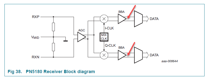

Kan_Li
The analog filtered/unfiltered signals are all from the signals after BBA. Please kindly refer to the following for details.
Hope that makes sense,

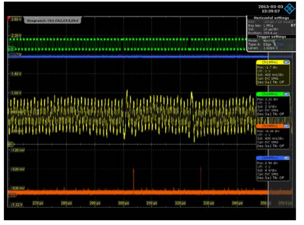

charlie3222112
@Kan_Li Thanks for your reply !
1 .Can I know the software of this picture ? (below the question)
2 .Can it receive any type of nfc analog signal? Or just type B?
3. Step 2 that you mention on the picture just select AUX1 to receive Q channel ,how about AUX2's setting will that be I channel ? or just keep it blank?
7,277 Views

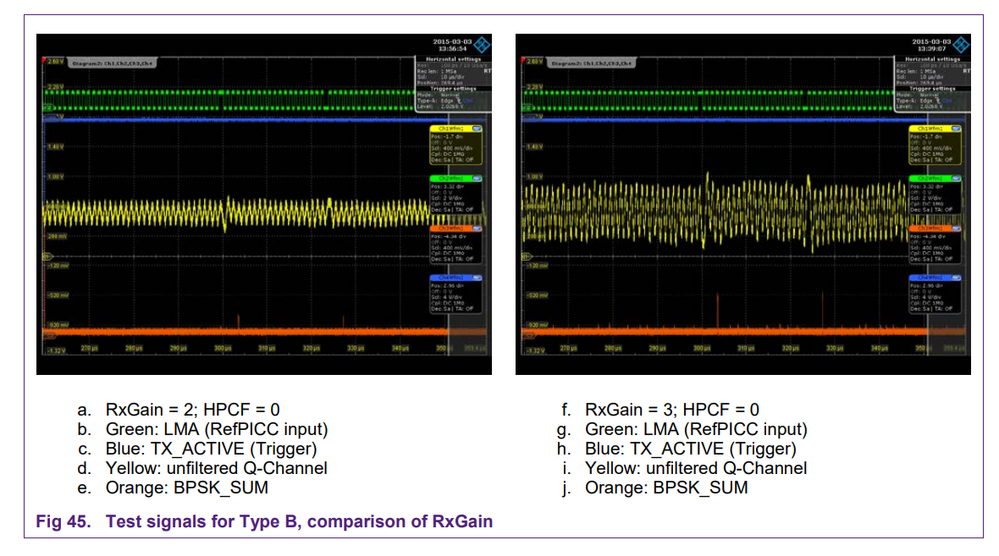

Kan_Li
Hello @charlie3222112 ,
- The software is just what runs on a oscilloscope.
- Of course you can receive any type of nfc analog signal.
- Actually it depends, for example, in Fig 45 of AN11740, both AUX1 and AUX2 are used for debug purpose, one for unfiltered Q-Channel, and the other for BPSK_SUM.
Kan

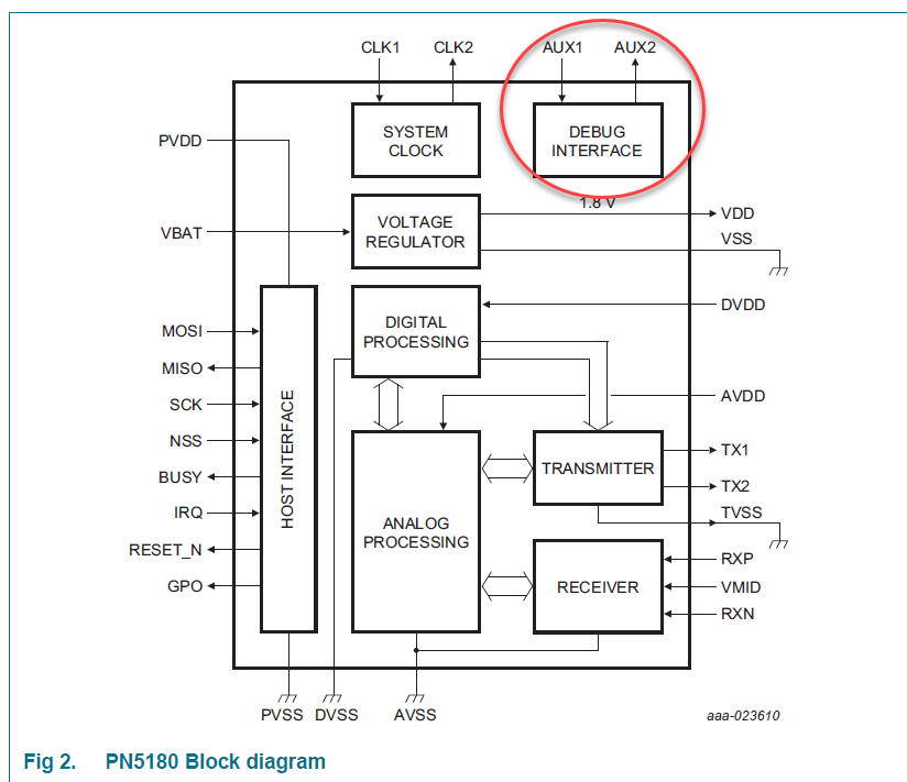

Kan_Li
There is debug interface available on PN5180, please refer to the following for details.
and you may refer to "11.6 Debug Signals" in the data sheet for more details.
Kan

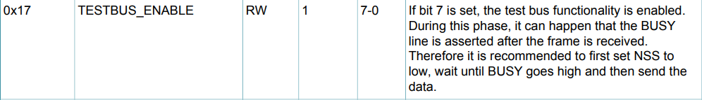

After viewing the document it shows that I need to enable the TESTBUS_ENABLE by configure some register value . Here are some questions I want to ask .
The first question is :
 I wonder the meaning "Therefore it is recommended to first set NSS tolow, wait until BUSY goes high and then send the data." in the document which is at 11.5.2 the EEPROM field . By the way, I could't find the NSS pin on my PNEV5180bm board.
Here is the picture from the document .
The second question is :
If I can receive that debug signal , will that be the Mifare's card (or any other nfc cards)signal or the signal which generate by the pnev5180 borad ?
The third is :
Can I get the analog signal range? Or it has some standard definations in any NXP's document?

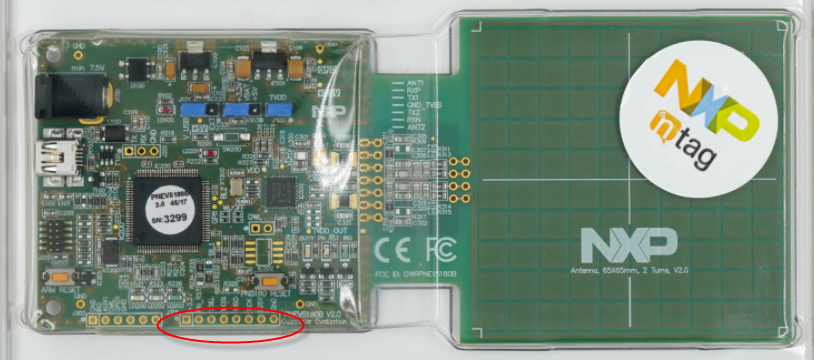

Kan_Li
1. NSS is one of the SPI signals, and you may find it on the board of PNEV5180B as below:
2. The debug analog signal can be configured to be signals from the receiver, so it can be the signals from NFC cards.we usually use these signals for receiving optimization, you may refer to section 4.5 in https://www.nxp.com.cn/docs/en/application-note/AN11740.pdf for more details.
3. Actually there is no such kind of info available, the signal range depends on your board design indeed.
