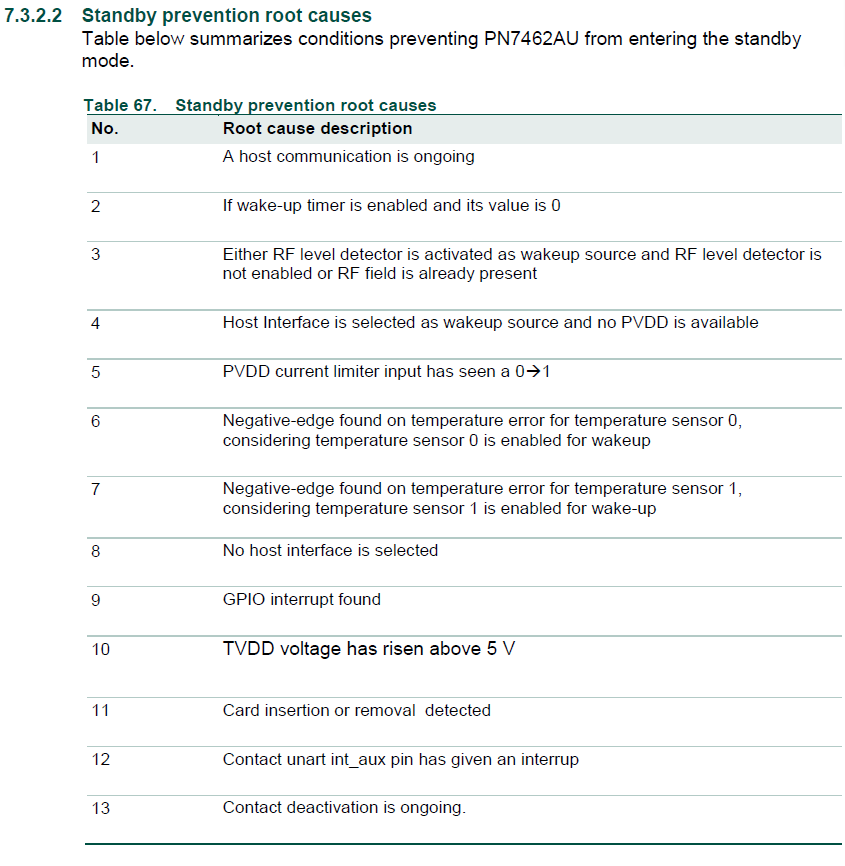

Hi I need to put in "stand by" mode the PN7462AU by the example: phExMain_noRTOS how can I do that?

Hi Gianluca Peterle,
All you need can be found in UM10858. Please refer to the following for details.
7.3.2.1 Entering Standby Mode
To enter standby mode, the firmware needs to operate in an infinite while loop of:
1. Programming the standby bit in the PCR_CTRL_REG.
2. Checking if there is any standby prevention reason.
3. If any reason found, then cater to the reason preventing entry of standby
Go back to step 1.
This loop will be automatically broken when PN7462AU enters standby and comes out. As this will reset PN7462AU and restart the boot.
