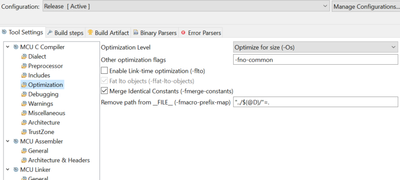

xiangjun_rong
Hi, Tom,
The release version of the project only selects "Optimization for size(-Os)" for the Optimization Level as the following figure. for size optimization, if you has function body, but you do not call the function, the function will be removed from the *.elf. For the variable for example hardware status which may be modified by hardware, you'd better add volatile before the variable.
for example volatile uint32_t capture_Value;
Hope it can help you
XiangJun Rong
12,381 Views
