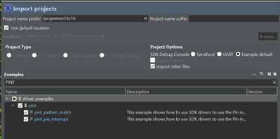

The following SDK examples show you how to use the Pin interrupt & pattern match:
Hope it helps you!
