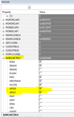

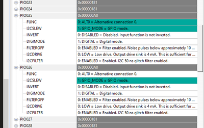

both ports of the gpio are initialized. The pins are type I and I can control with the same method pins:
  • 23
  • 24
  • 27
  • 28
the only ones that i can't control is those 2:
  • 25
  • 26
IOCON are configured as follow:
but the state of the gpio no matter what remains low.
3,717 Views
skanda19
the only way i can switch the line state, is when I change the invert bit. while this can be a work around, i would like to understand why is this happening ?
thanks,
RB

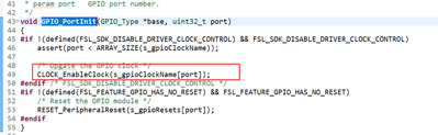

Hello @skanda19
You can refer to "led_blinky" demo to config gpio.
Check whether enabled gpio clock.
Alice
