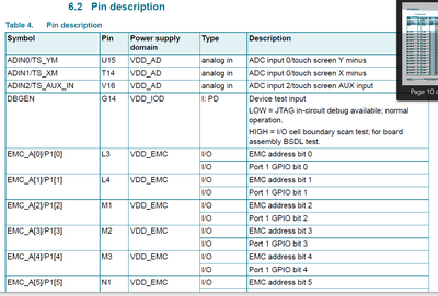

Pls refer to data sheet of LPC32xx, the attribute of a pin is input(I), Output(O), bidirectional(I/O) , analog, power.
For the bidirectional I/O pin and Input pin, I suppose that the state of IO during the period from power-on to boot are in input mode, except for JTAG pins.
