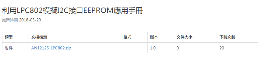

I saw the example code from NXP.
After I open it, it is for Keil IDE.
My customer use MCUxpresso.
Does NXP has it for MCUxpresso version?
if yes, please offer it to me.
http://www.nxpic.org/document/detail/index/id-14931

Hello Li-Chin Wang,
Please noticed that the link that you attached is not official from NXP. In the following link you can download the official application note along with the code:
In the .zip you will find a folder named Source_Code the code that is located in this folder can be used with MCUXpresso. Also, the LPC804 now has an SDK you can download it from the following page:
In the SDK you will find examples of the I2C protocol among any others.
