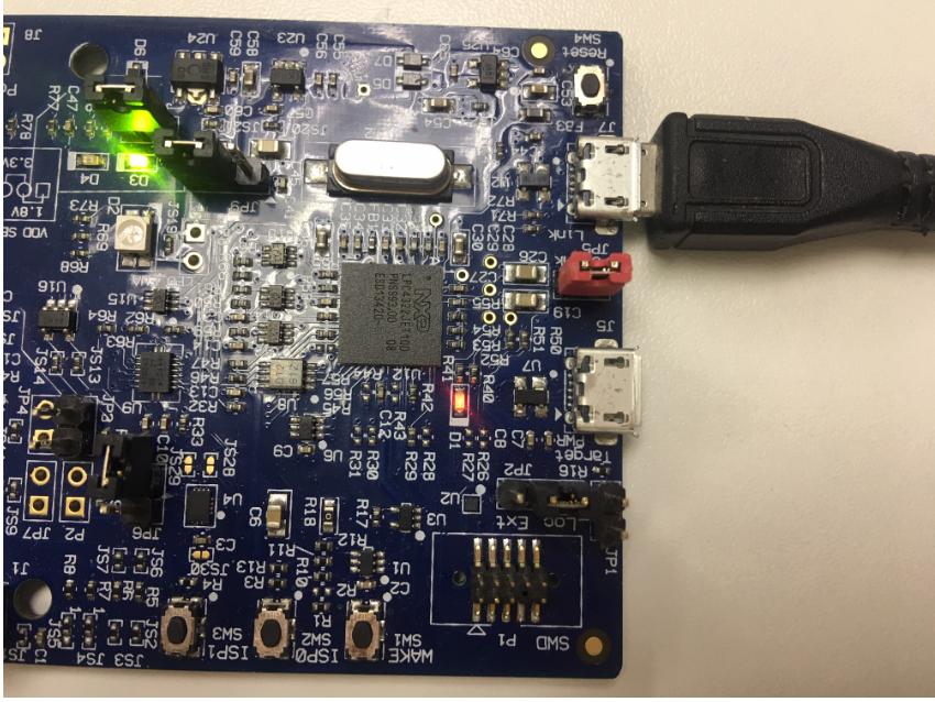

Hi Bill Carpenter
I just tested LPCXpresso5411x with J7 connect the board, Jlink interface works well. I can download/debug code via its interface without problem.
1. first please check if the jumper setting is correct. This is my setting. see attached picture.
2. in order to test, create a new project in A NEW workpace with wizard, test if the jlink connection can work.

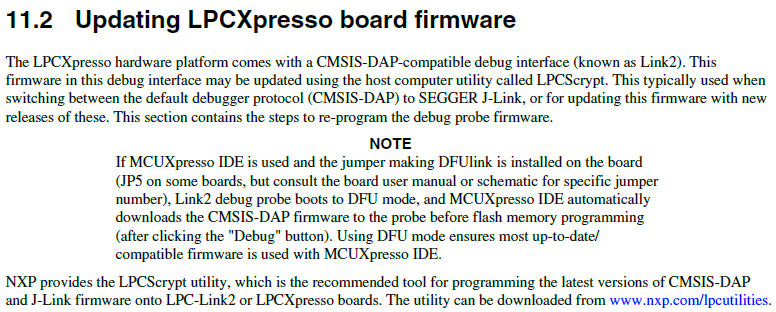

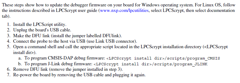

3. if still fails, please update the firmware, you need connect J5 while updating. see steps below, I extract them from Getting Started with MCUXpresso SDK.pdf under SDK package:
Jun Zhang

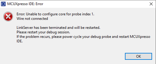

Hi Jun,
I work together with Bill Carpenter and am experiencing the same issues with the LPC54114. I am trying to follow the hello_world readme. "Hello world" is printed to the console when I just plug in J5. However, when I plug in both J5 and J7 I receive the attached error message (See image). Any idea what the issue could be?
Dylan

ZhangJennie
When use MCUXpresso IDE connect board via J7, you can't plug in J5.
Plug-in J5 is only needed when use LPCScript update firmware.

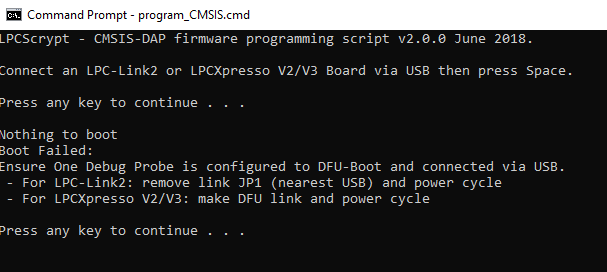

dwagner1
Hi Jun,
I still receive the same error message when I go to debug using J7. When I try to update the firmware using LPCScript and plug in J5 I receive the attached error message.

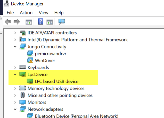

ZhangJennie
Three points you need to check when update the firmware:
1. make sure J5 connect. refer jumper setting of my side:
2. check device manger, if  LPCDevice is detected:
3. Refer attached video to update firmware. if your board is not damaged, it should work well.
