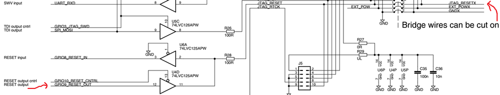

Estoy trabajando con el LPC1102 conectado a través de un LPCLink y en el firmware configuré los pines de SWDIO y SWDCLK como GPIOs. Ahora no lo puedo programar, pero entiendo que al hacer reset con el pin de RESET, las funcionalidades de estos pines vuelven a ser de SWD momentáneamente hasta que el firmware vuelve a configurarlos como GPIO.
Al comenzar la sesión de debug, no se hace un reset desde el pin de reset del LPCLink?
IN ENGLISH:
I'm working with the LPC1102 mcu, connected to the PC through an LPCLink. The firmware configures SWDIO and SWDCLK pins as GPIOs. So, the debugger can't connect to the target anymore. But I understand that the Reset state of that pins are SWD function, so, when the debugger starts, why it doesn't send a low state to the RESET pin before start the flashing of the mcu? How can I do that?

In the LPCXpresso LPC1114 schematics I see that the LPCLink microcontroller, the LPC3154 has one pin, MGPIO9 called "RESET_OUT", with a pull-up resistor, connected through a buffer (74LVC125APW)to the JTAG-RESETX pin of the connector that links to the target. The buffer one habilitation pin (GPIO10_RESET_CNTRL). I attach two images showing this, so you don't have to look up for it.
My question is how can you control that pin than connects directly to the reset pin of the target, without having to validate the connection to the core. In other words, I want to control that pin through the debugger, not send the reset request to the core. Only put the RESET pin down through the debugger. Is that possible? and if not, why has the LPC3154 that output connected?
best regards!

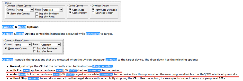

Hi Federico Roux,
After contact with the ARM technical support engineer, the Reset bin is able to reset the MCU depend on IDE configuration, noting with the SWD or JTA protocol , for instance, KEIL.
You can find similar information in your IDE user's guide.
