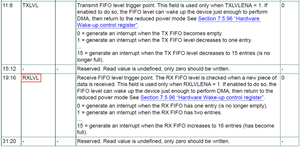

I have a problem finding information how to receive interrupt when the RX-FIFO in the Flexcomm module is partly filled. When the configured limit in the FIFO is reached, fine, but what if it is not reached. We have experience form the LPC24xx and LPC40xx peripherals where an interrupt is triggered as soon as the flow stopps and the remaining bytes in RX-FIFO can be read out. I have seen solutions with a separate timer but is this the only solution, really? I hope we miss something important!

We have been using the LPC2468/LPC4078 for about 10 years (or more) and using a lot of UART peripherals in our application. We are looking at the LPC540xx or  LPC546xx family that has the Flexcomm design for UART's. We are using FIFO to minimize number of interrupts. In the LPC24xx/LPC40xx uart peripheral there is a CTI (Character Time-out Indicator) that triggers an interrupt if no Rx activity has occurred in 3.5 to 4.5 character time so the fifo can be flushed to application level. So, for example, if the FIFO is configured to trigger an interrupt after 14 received characters and we only received 10 and no more (for a while), the CTI feature will handle this use-case.
How is this use-case handled in the Flexcomm peripheral design?

The CTI feature can provide a 'kind reminder' to read the remaining data in the receive FIFO, what a pity, the LPC54608 doesn't support this feature.
So I'd like to share a method to achieve the same function.
The LPC54608 can trigger an interrupt on FIFO receive level reached and the receive level is customized, it's available to receive all the in-coming data stream in the interrupt handler when setting an appropriate receive level.
