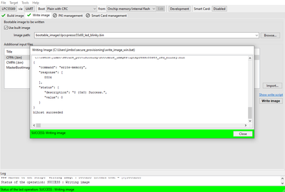

jimmy979
Hi, Yes I can erase flash. I did it using these commands:
Also, I can write a CRC image using MCUXpresso Secure Provisioning application.
I have not configured CMPA or CFPA manually but maybe MCUXpresso Secure provisioning application did? I found CMPA and CFPA configuration through MCUXpresso Secure provisioning app.

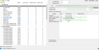

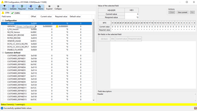

jimmy979
I think I can't update the ROTKH field in CFPA with MCUXpresso secure provisioning tool. Can I update ROTKH manually through ROM API?
Also, what is the procedure to build and write TrustZone images? Is it possible that your TrustZone project consists of two images or only applies to one?

4,302 Views
Hello ,
1) You can refer to
"5.4 CFPA page preparation" of AN12283, pay attention:
2) About Trustzone project, there is demo under SDK, you can directly refer to.
