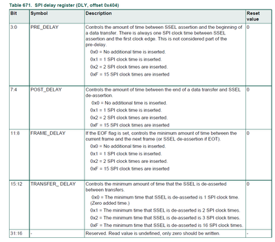

Help needed, i need to perform a usb burst of a stream of high speed usb of 1024 byte of data through spi. However i do notice the receiving SPI byte byte 2 byte interval takes up about +-500ns.
Can we further reduce the receiving byte 2 byte interval? which is currently being measured at +-/ 500ns.
i have configured my SPI as follows:
SPI Speed = 48mhz
SPI Configuration as follows, for Flexcomm 0;

As you know that there is a delay register, which has 4 delay items, you set them all 0. So the delay configuration is correct, there is not improvement space.
Regarding the delay between two transfer you have observed, I suppose that it may be resulted from the cause that  the SPI transmitter FIFO data is not ready when the first two bytes data has completed or SDK driver inefficiency.
You can enable the FIFO mode and set the TXLVL/RXLVL as 7, so in the ISR of SPI, you can push 7 half-words to the WRFIFO, pls have a try.
If you pursue speed, I suggest you do not use the spi SDK driver, you can write register directly and use interrupt mode, the SPI SDK driver is inefficient.
Hope it can help you
