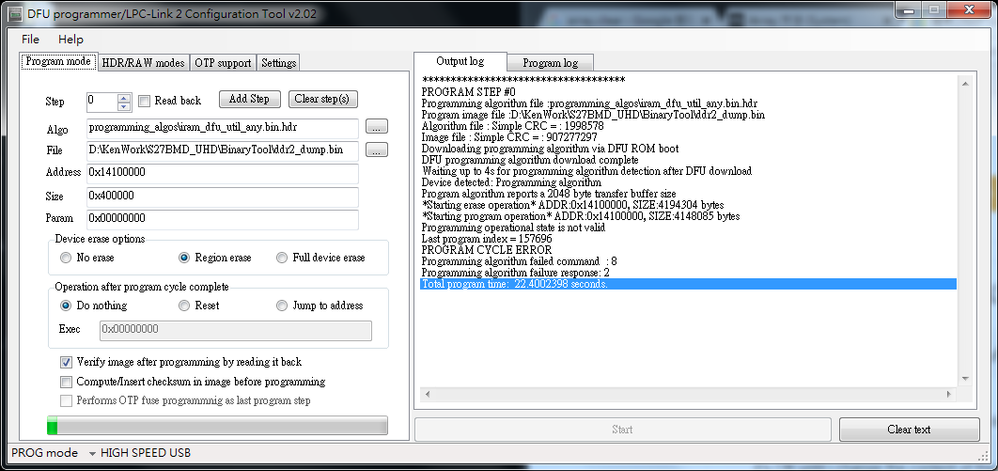

hi I am using DFU tool to write binary data into qspi flash,
it's OK until i change the content of the binary file.
It's hard to understand why different binary file will has different result.
My MCU is lpc1830, flash size is 8MB
Could you help to confirm the failed log and check if the binary file(bin_NG.bin) has something wrong?
Ken

Dears
The issue is solved,
I changed the programming_algos to "spifiv2_iram_dfu_util_any.bin.hdr", this issue is solved.
I check the release note if  xxx.hdr file
It's seems that it should use spifiv2_iram_dfu_util_any.bin.hdr?

Hello Ken Su
Yes, you should use this algorithm from now own.
I recommend you to take a look to the tool LPCScrypt. LPCScrypt is a command-line based, fast flash, EEPROM, OTP and security programming tool for LPC1800 and LPC4300 series microcontrollers. Please refer the following link to read more about this tool. LPCScrypt v1.8.2|NXP
Hope it helps!
