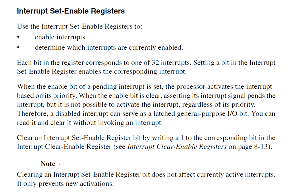

Looking at the one of the implementations of NVIC_EnableIRQ, Im wondering how the ISER works ?
<code>
static __INLINE void NVIC_EnableIRQ(IRQn_Type IRQn)
  NVIC->ISER[((uint32_t)(IRQn) >> 5)] = (1 << ((uint32_t)(IRQn) & 0x1F)); /* enable interrupt */
}</code>
Calling the above two consequitve times with a different IRQn, will erase the enable of the previous interrupt. Does it mean I can enable one interrupt at a time?
<p><code>
NVIC_EnableIRQ(8);   // enables IRQ8
NVIC_EnableIRQ(7);   // enables IRQ7 but disables IRQ8 ?!?
</code></p>
Correct, or do I miss something? Am I enabling two IRQs at a time? If yes, how is it possible, if ISER[0] would contain only the last assignment....
Further, can I set an IER of a peripheral device without enabling its interrupt ?!?

You need to read about the NVIC peripheral for the processor you are working on.....
The ISER register:
(Hint: setting a bit in this register enables the interrupt for this one only, all other interrupts are NOT affected, same with ICER register)

Where do you infer your hint from above from ? Are you talking about NVIC_EnableIRQ at all?
The fist part of the question is setting ISER with the NVIC_EnableIRQ? And the second part is what is the relationship between the ISER and UART->IER registers ?
