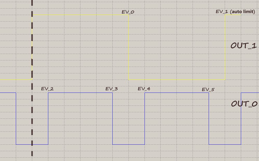

keyzet_89
Good afternoon, Omar.
In fact, I need to get something like this output signal. Two outputs, the frequency is 2 times different and there is a phase shift. The severity is different. Thus, output_1 is obtained as in the example with Simple PWM. However, output_0 will have 4 events - 2 on SET and 2 on CLR. The total number of events 8 does not exceed. After re-reading the user manual, I did not find in it restrictions on the number of events per output.
Sorry for such a weird schedule. The brown dotted line is the beginning of the counter.
Best regards, Владимир.

Omar_Anguiano
Hello Владимир Орлов.
I agree with you, the number of events needed for your application does not exceed the permitted one. I suggest to check this example as a guide to design your application "max_sctimer_multi_state_pwm". This example can be found at the sdk.
On the example focus on the function SCTIMER_SetupPwm(). This function configures the PWM parameters and sets 2 events with SCTIMER_CreateAndScheduleEvent()
Use this function as reference to design your function for the PWM of your OUT_0. Add the events with SCTIMER_CreateAndScheduleEvent()
You may find a more detailed explanation of each function at the example driver.
Let me know if this is helpful
