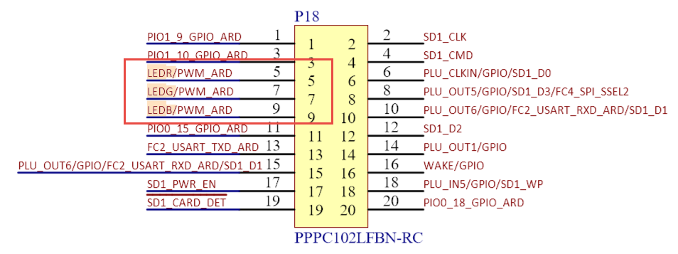

In the user manual of LPCXpresso55S69, paragraph 7.4 (p 16), it is noted that the LED port lines are connected to the expansion connector J18. I could't find where or what is the J18, any idea?

Check the schematis. It is actually P18:
