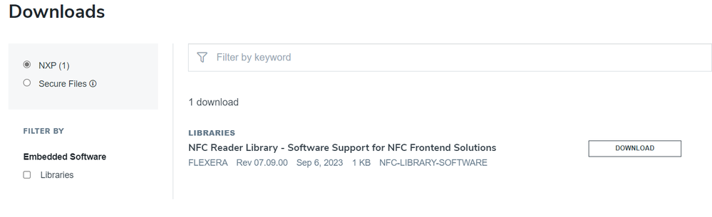

EduardoZamora
NfcrdlibTst12_Rc663Lpcd example project is included in the NFC Reader Library. You can download the library corresponding to your device from the Downloads section of the webpage:

EduardoZamora
