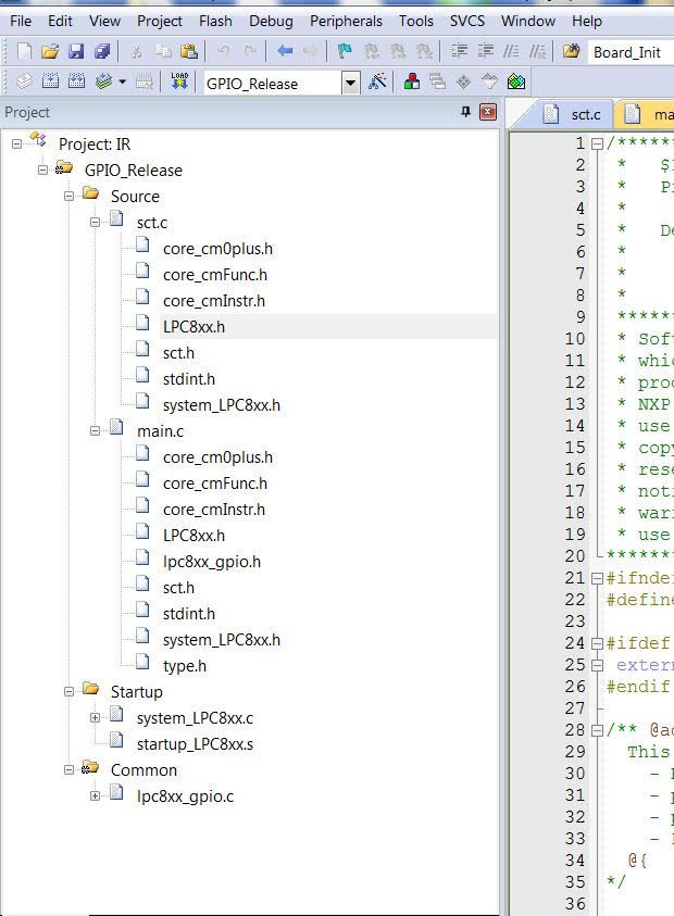

Hi I download the IR remote controller/ receiver example form the following website.
https://www.nxp.com/products/processors-and-microcontrollers/arm-based-processors-and-mcus/lpc-corte...
I downloaded Keil version 5 to run the project which is version 4 project. Hence I downloaded the legacy support in order to open version 4 project in Keil as shown in the attached picture.
I think there should be more c and h files instead of just files related to GPIO. Like lpc8xx_mrt.c, lpc8xx_uart.c, lpc8xx_sct.c etc.
Could you help me on this? Thank you very much!

   No, the project is correct, no files is missing.

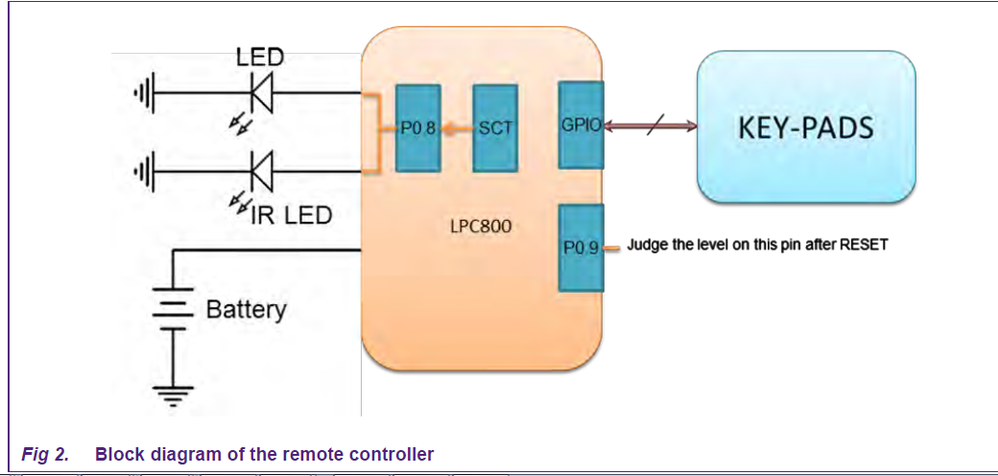

  If you check the AN11511_1.pdf, you will also find it is correct, please check this block diagram:
It use the SCT, gpio to realized it.
Wish it helps you!
