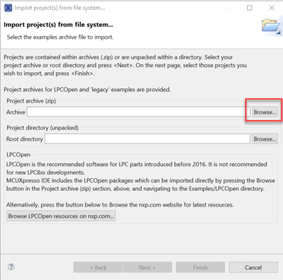

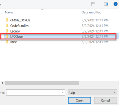

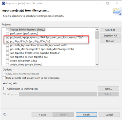

Pablo_Ramos
Hi @Bela1,
You can try an example of the LPC1768 in order to see if it's a configuration issue.
You can export and LPC Open example in MCUXpresso following the next steps:
Inside this folder you just need to search for your LPC.
Also, there will be two examples named lpc_chip and lpc_board, these two projects are needed in order to build any project, just make sure there are open in the same workspace as the example you want to build
You can also use the build all button in order to build the three projects at once.
Hope it helps you!
