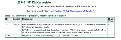

I am working with LPC54S018 EVK and want to generate maximum SPI clock frequency. Below are my observations:-
1. Getting 12MHz clock inspite of attaching HF clock (kFRO_HF_to_FLEXCOMM9). No effect of increased baud rate. (All the SPI pins are connected)
2. Getting 48MHz clock when kFRO_HF_to_FLEXCOMM9 is used and baud rate is set to 48MHz. In this case, only SCLK is connected, other SPI pins are not connected.
Let me know how can I generate maximum SPI clock o/p frequency? Can I use FLEXCOMM0-9 to generate maximum SPI clock o/p? (FLEXCOMM10 is not available on EVK)
Also suggest what changes are required to generate max SPI clock o/p frequency?

Regarding the maximum SPI clock frequency of LPC54S018, pls refer to the data sheet of LPC54S018, the master mode, the SPI baud rate is 48M bit/s, in slave mode, the baud rate is 14M bit/s.
Assume that you want to get 48MHz for SCK signal, If you use the code  kFRO_HF_to_FLEXCOMM9, the SPI drivig clock will be 48MHz.
and you have to set up the SPI baud rate by writing the SPI divider regisyter as 0, the SPI_SCK clock frequency will be 48MHz.
Hope it can help you

Please review my code changes as below. I have done modification in spi_dma_transfer demo app available inside SDK.
1. Added these lines.
/* attach 12 MHz clock to SPI2 */
CLOCK_AttachClk(kFRO_HF_to_FLEXCOMM2);
/* attach 12 MHz clock to SPI9 */
CLOCK_AttachClk(kFRO_HF_to_FLEXCOMM9);
2. Added this line.
masterConfig.baudRate_Bps = 48000000U;
Let me know in case anything is missing here.
