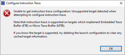

I am using MCUXpresso v11.5.0[Build 7232][2022-01-11] with the LPCXpresso812-MAX Board.  I have started a fresh workspace and have created a project by importing an SDK example.  When I try to use the MTB I get a notice
"Unable to get instruction trace configuration.  Unsupported target detected when attempting to configure instruction trace........."
The data sheet for the LPC812M101JDH20 says that MTB is supported.  I must have missed setting something up to enable the tracing but I have searched many places and have not found an answer.
What has to be set to enable the trace buffer?

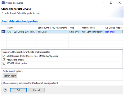

Could you please show me a screenshot of how your board is enumerated once it is connected to your computer?
4,572 Views
jimpearce
I hope that this is what you are asking for.  If not, please let me know.  Thank you for your help.
4,548 Views
DanielRuvalcaba
Yes, that helps, thank you very much.

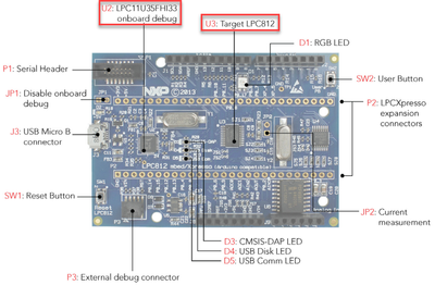

What I see is that your computer/IDE is detecting your board as the LPC11U35 that mean that uses the on-board debug probe. This one doesn’t have an MTB module, this might be the reason why you are having problems.
If you would like to debug the LPC812 (the one that has the MTB module), you will need to use an external debug probe.

It’s not like the board doesn’t support MTB, you just have to debug the LPC812 with an external debug probe, because the onboard debug probe uses the LPC11U35.
For the supported external debug probes, please refer to section 4.1 of the LPCXpresso812-MAX User manual.

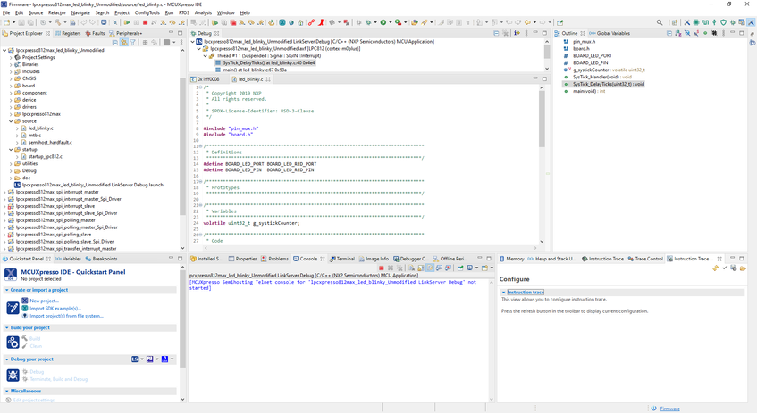

I had already tried all of the suggestions in your attached documents to no avail.  I reduced the problem to ist simplest form:
Unfortunately, that did not help.  I have reduced the problem to its simplest form:
I am using an unmodified LPC812 mbed/Xpresso (Arduino compatible) board and the lpcxpresso812max_led_blinky SDK example.

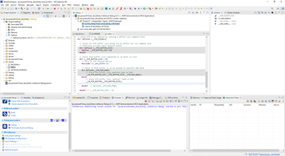

The example code shows that it includes cr_mtb_buffer.h and mtb.c as part of the project.  It builds with no errors or warnings.  When I run it in debug mode and select Window->Show View->MCUxpresso IDE Trace and Energy Measurement->Instruction Trace Config and then click on the refresh icon in the Configure window, I get this:
If you can get the tracing to work with this simple setup, please detailed instructions of how you did it or post a link to a video of it.

Can you please make sure that your project is making use of the cr_mtb_buffer.h and the mtb.c files?
I also dropping you some links that can be useful to solve your problem.
https://www.nxp.com/docs/en/quick-reference-guide/MCUXpresso_IDE_Instruction_Trace.pdf
https://community.nxp.com/t5/LPC-Microcontrollers/Instruction-trace-not-working-on-LPCXpresso54628/m...
I hope this helps, Daniel.
