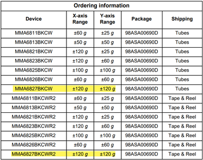

Thank you very much for your previous answer. I wonder if the MM6827 can set the range and sensitivity? I didn't see the specific register, thank you very much!
1,873 Views
diazmarin09
Thank you for reaching out to us.
I am afraid that both the range and sensitivity are fixed.
Please let me know if you need a further recommendation for a replacement device.
