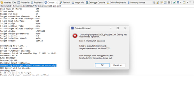

anbui
I'm unable to get the external segger to work with the board.

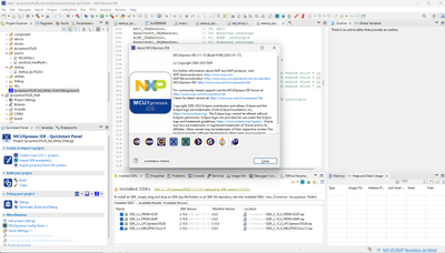

anbui
My setup :
My MCUXpress is v11.5
My JLink is v7.86
We tried on a clean new dev board and still experience the same issue.
I would not thinkt 11.5 vs 11.7 would be the issue, but I will install a new 11.7 and try also.
Do you have any other suggestions on what is causing this issue?

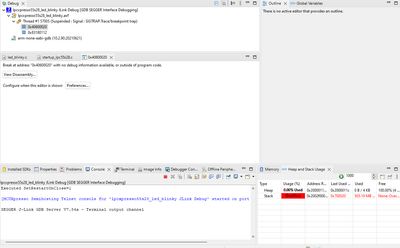

12,566件の閲覧回数
anbui
Downloads and runs but wont let me debug.

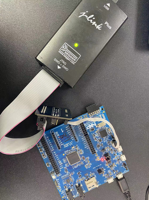

jtauch1
Hi Jun,
I am working with An on this issue. We are in the process of fabricating our own custom LPC5526 board. We would like to verify that the seggar debugger we have will work. As An mentioned we are able to program and run the code, but the debug features are not working.
We are concerned that when we receive our custom boards we will not be able to debug the boards. Can you please help us understand the current limitation and possible work arounds?
I guess that we might be able to use the LPCEVM as a debugger and connect to our custom board via the 10pin debug header. I believe this was mentioned in the user guide.

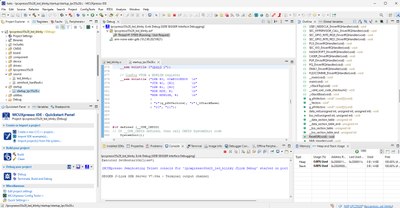

12,448件の閲覧回数
anbui
You can see my version and sdk is up to date.
I'm still unable to debug.
If i pause it then I get
I've attached the segger log.

12,340件の閲覧回数
ZhangJennie
You use demo board+external jlink debugger, please send me a photo here, I need to check your board jumper setting. Thanks.

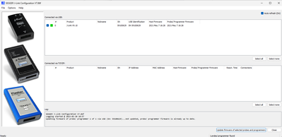

ZhangJennie
Please shunt J3 to ext,2-3, and try again.
If still fail, I wonder your Jlink firmware is old. I suggest you contact Segger to update the latest driver/firmware.
