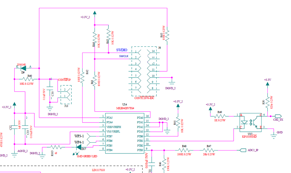

Is there any possibility to download code through UART in MKE04 controller. No ISP pin is observed Datasheet.

Flash magic doesn't support KE04.For more details ,attch file is flash magic latest version.  Or you can also download it from Flash Magic - Download .

There doesn't have ISP function on kinetis,but we have SWD. According to your schematic,you have made J6 as SWD for downloading code . You only need a SWD emulator like jlink or cmsis dap.

      I have given only SWD provision in J6 but, I want to know is there any possibility to download code using flash magic tool (using UART).

You can dowload code through uart with bootloader.  And ,if yours is FRDM-board.There has a K20 on the board,can be set as Jlink,PEmicro,cmsis dap.and others,can be used to download code via a usb cable  .

Thanks for your reply. We don't have any FRDM-board. We have our own schematic. Schematic has been provided below. But No UART terminations are provided. Please explain how to download code using USB to TTL for the below circuit. Please provide ISP pin for code downloading.
