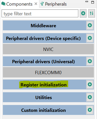

  1. Open ConfigTools -> Peripherals.
  2. Then, in Components section, go to Register initialization.

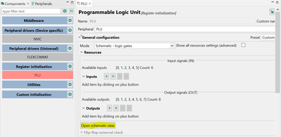

  1. A new window will open, please select PLU

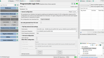

  1. Now the Peripherals window should look as below:
Click on the Open Schematic View.
  1. Finally, go ahead and create your schematic.
