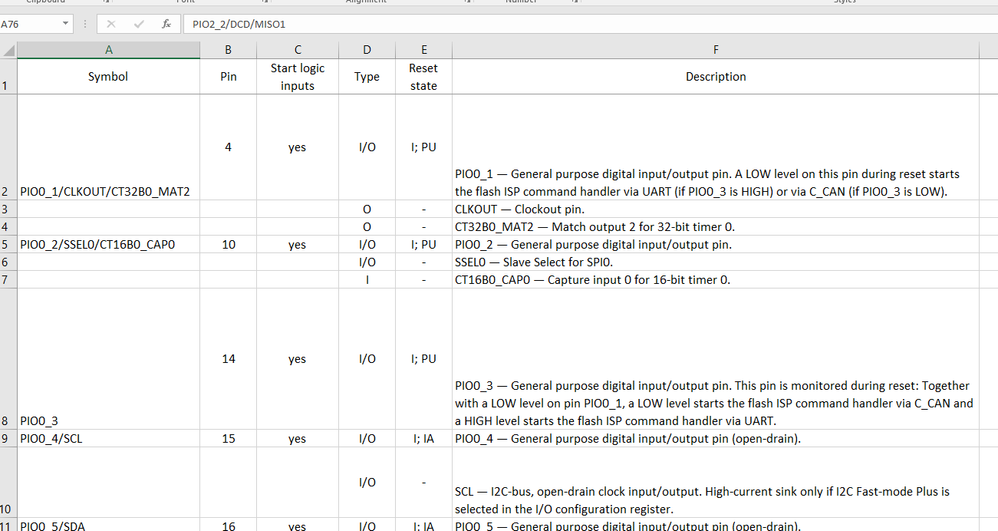

I want to have an overview of all the pins for LPC11C24 and their exact functionality/capability(pull-up/down, I/O etc).
Is there eg an Excel file that contains all the information about the MCU pins ?

Yes, I know/knew about the info in the docs you mention. But I want to have this info in the form of a table in eg Excel. What I am about to do is to manually copy all the data from the PDF into Excel. So before I do that tedious job I ask if there is already such a table/ someone esle created it. I think I've seen this type of an overview in other manufacturers. And I suppose internally NXP must keep this info in the form I am looking for.
example

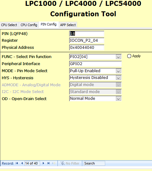

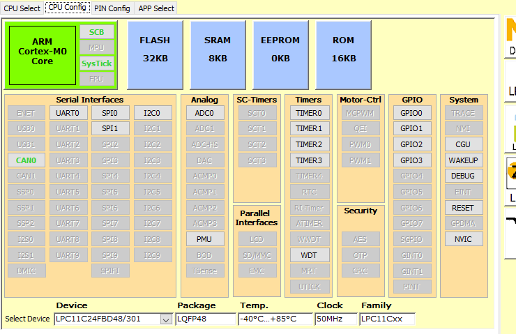

it seems as this tool does not work well for LPC11c24, I try to configure CAN and it does not work. Here:

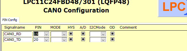

Now I want to configure CAN pins and it is not possible. Anything I select from the drop down menu it will not be applied. Whatever I do it always stays like this :

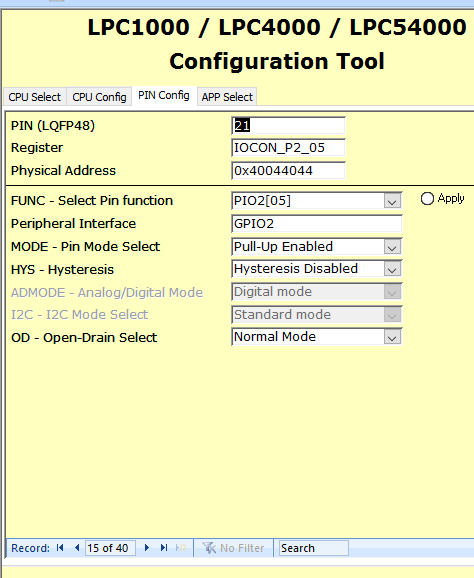

And pins 19 and 20 (again CAN interface) are not available. When I go through the list of pins they are missing :
and when I press 'next' I get pin 21:
This tool seems to be incomplete or am I doing sth wrong ?

CAN TX and CAN RX can not be relocated, they are fixed on pin 19 and 20.
4,860 Views
adamrakam
Correct, thank you Carsten.
