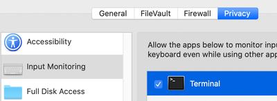

Just got the new mcu link board. Tried to update it but this one fails..
./blhost --usb 0x1fc9,0x0021 get-property 1
Error: UsbHidPeripheral() cannot open USB HID device (vid=0x1fc9, pid=0x0021, sn=).%
It's enumerated by the mac correctly
USB COMPOSITE DEVICE:
Product ID: 0x0021
Vendor ID: 0x1fc9 (NXP Semiconductors)
Manufacturer: NXP SEMICONDUCTOR INC.
Location ID: 0x14100000 / 8
Current Available (mA): 500
Darwin imac.local 19.6.0 Darwin Kernel Version 19.6.0: Thu Jun 18 20:49:00 PDT 2020; root:xnu-6153.141.1~1/RELEASE_X86_64 x86_64
(i.e. Catalina, 10.15.x)
thoughts?
18 Replies
9,730 Views
dav1
Contributor V
found a workaround... but this feels wrong as it's a security risk having terminal apps being able to sniff the HID bus
checked this box in settings, restarted the terminal. seem ok
blhost -V -d --usb 0x1fc9,0x0021 get-property 1

I’ve not tried this, but have you tries using sudo instead of the privacy settings?
9,725 Views
dav1
Contributor V
sudo is required by default, not sure why, but I guess due to hid access being non explicit in the blhost source (IOHIDManager on mac passes in Null)

please please read my first post. board is in bootloader mode, you can see this from the usb vid string (and I can see it from the fact the led is red)
your issuein blhost starts with macOS 10.15 and forward due to new security restrictions
please try in 10.15 and 10.16 and you will see for yourself

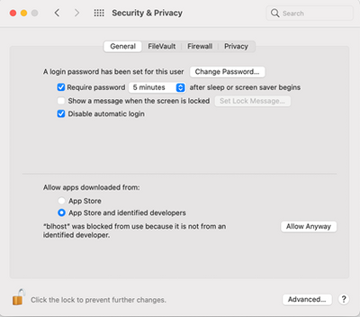

ZhangJennie
here is response from SW team:
Yes, I believe this is related to the app notarization requirement that is enforced starting with macOS Catalina for software distributed outside of the App Store.
In case of apps which cannot be verified, there is a notification like below, and the user needs to specifically allow the application in Security & Privacy Preferences the first time it is executed.
It's a nuisance, indeed, but the good news is that it should now be easy to address. The upcoming IDE 11.3.0 release will be the first one to ship with notarization on macOS, so we have already gone through the necessary infrastructure steps and we are now able to sign/notarize the binaries, so it's just a matter of packaging a signed version of blhost inside the firmware update package.
(As a side note, the readme only mentions macOS 10.13 - so prior to the version that mandates app notarization)
Regarding running as root, now that you've mentioned it, I realize it's inconvenient as it prevents using the utility through double-clicking in UI (and requires using a terminal). I'll need to check if we can do something to relax the requirement.

First make sure J3 is installed.
We tested on OSX10.15, failed because Apple couldn't versify blhost was safe.. The release was checked with 10.13.
We will check it.
