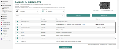

I am currently facing an issue with installing the SDK on MCUXpresso IDE.
I generated the SDK for the IMX93 board on the website.
After downloading the SDK, I tried to drag the card into the Installed SDK tab, but encountered an error as shown in the picture. Can you please help me with this?
TuanLam_0-1706678533253.pngTuanLam_0-1706678533253.pngTuanLam_1-1706678555997.pngTuanLam_1-1706678555997.png
3,585 次查看
xiangjun_rong
Unfortunately, I only support LPC family, I am not sure if you can use MCUXPresso tools to compile/link SDK example for i.mx family.
This is i.mx forum, pls create a ticket for i.mx family and ask if the MCUXPresso tools supports SDK for i.mx family
