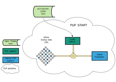

I am using lpc55s69 in order to get advantage of the PUF example which is given by the SDK. Is there any way to extract the complete available fingerpring of the PUF memory? I would like to use it in a different way than the one which is given in the example.

I may not understand your question. Could you please specify what is " complete available fingerpring of the PUF memory"? Do you mean you want to extract all KC(key code)?

In order to be more specific I took this figure from PUF manual. I would like to have independent access to SRAM stable data and the final Digital fingerprint.

PUF SRAM  s not constant.  Each new Enroll generates new data.
And there is no way to extract PUF SRAM data. If this can be done, the chip is not safe.

By fingerprint I mean all the stable cells of memory which is used by PUF. I would like to create a stability map in order to use it in a different way.
