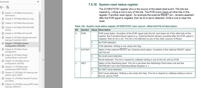

Hi, How can we identify the source of reset for LPC54628? I mean, can we distinguish between various types os resets such as POR, BOD, WDT, software etc by checking some register value after coming out of reset? I tried going through the user manual UM10912 but was unable to find the information. Thanks..

It's in the Users Manual
