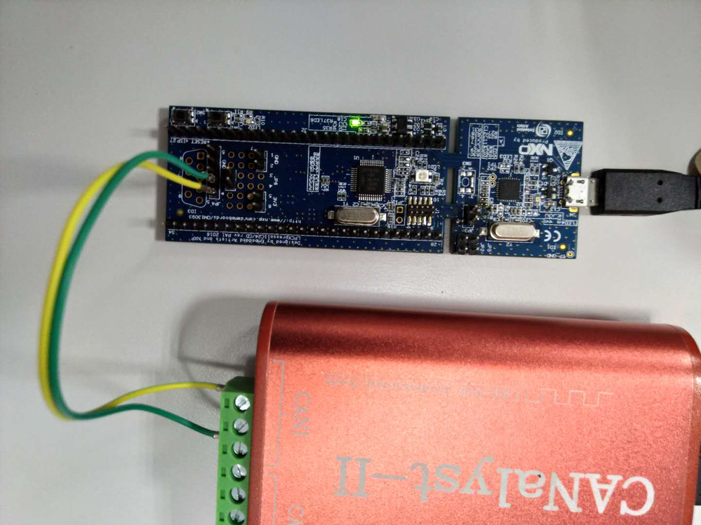

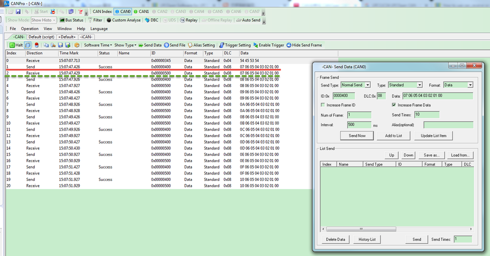

jeremyzhou
Hi mat ric,
Thanks for your reply.
I'd like to illustrate the testing I did.
1. Program the periph_ccan_rom an LPCXpress LPC11C24 board.
2. The CAN analyzer simulates an LPCXpress LPC11C24 board, then connect the really LPCXpress LPC11C24 board.
3. The CAN analyzer repeat send 10 of frames, and it receives 10 responses from the LPCXpress LPC11C24 board.
Fig1 CAN analyzer tool
Fig2 Hardware connection
TIC

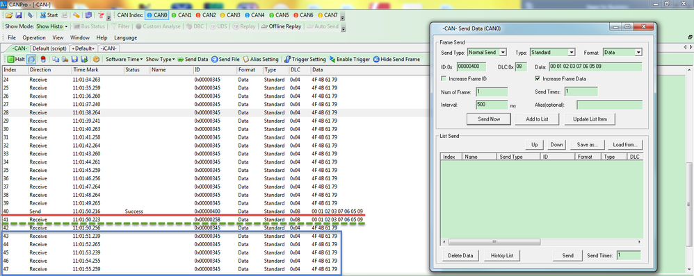

finalargasio
Dear Jeremy,
I have found out that the Board does receive the message as when a message is received, the interrupt is generated, however the IRQ handler does not call or at list does not jump to the CAN_rx isr, how come is that? Do you have any clue?
9,046 Views
jeremyzhou
Hi mat ric,
I've not encountered the phenomenon you describe, actually, your code works well with LPC11C24 board.
Note; I modify a bit segment of code, however, it doesn't affect the main function of the code.
You can review the modified code and testing result at below.

Fig 1 Testing result.
