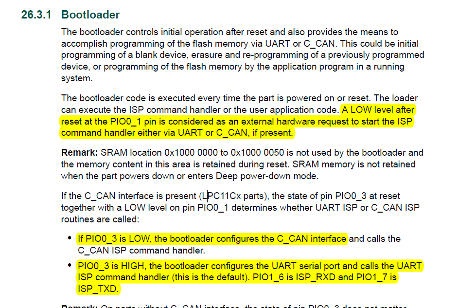

Hello guys,
I am new to embedded programming and I want to ask some questions. I have a project where I need to measure time interval between two rising edges (formed by a Hall sensor). I plan to use a counter with a capture so I can measure the time interval between 2 rising edges and display that through a UART serial connection. For the time being I am trying to just to read the value of the TC at moment when a capture event occurs on the pin ( CAP PIN1_5 - for TMR32B0). The strange thing is that when I try to flash this code into the memory my UART stops sending, while I am using debug session and USB cable everything is OK. My point is that I need to flash that into the memory so I can connect the Hall sensor to the capture pin and supply the board with an external power supply in order them to share a common ground.
Here is my code:

Hi Vasil Borisov,
    Two points you need to note:
1. When you program the chip, you need to download the code to the flash, not the RAM.
    After you download the code to the chip flash, both debug and without debug, the code can work.
   But if you download the code to the RAM, after power off and power on the board again, the code will be disappear.
   So, please configure your project, download the code to the flash.
2. Note the PIO0_1 pin when you do the reset
After you download the code to the chip, without debugging, before you do the reset, you must make sure PIO_1 is high, otherwise, you code will enter in the ISP mode.
So, just keep the PIO0_1 as higher.
Wish it helps you!
Kerry
