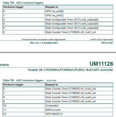

In table 753, it looks like CTIMERs are mistakenly called "State Counter Timers". Hardware trigger 11 is listed as "ARM tx event" but that's not defined anywhere that I can find. What is this interrupt? All Google results for "ARM_TXEV" come back to NXP docs and it's never described, as far as I can tell.

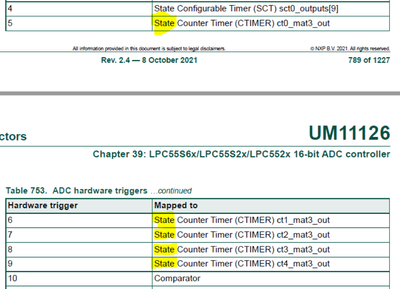

The error I'm referring to is here:
There is no "State Counter Timer". The SCT is the State Configurable Timer. The manual describes CTIMERs as "standard counter/timers" - they don't have "state" anywhere in the name.

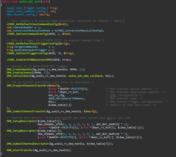

The example you sent me, and the code I ended up with on Saturday, use DMA_PrepareChannelTransfer(), DMA_SubmitChannelTransfer(), and then DMA_SetupDescriptor(). The channel chain demo uses DMA_SetChannelConfig(), DMA_SetupDescriptor(), and DMA_SubmitChannelTransferParameter(). The interleave transfer demo uses DMA_SetupDescriptor() and DMA_SubmitChannelDescriptor(). None of them provide any explanation of why they use the calls they do. The "Typical use case" section only says to see the demos. The demos provide no useful comments. I'm still not sure why DMA_PrepareChannelTransfer() is needed in my code and why I can't use DMA_SubmitChannelDescriptor() like the interleave demo but I haven't had time to look more closely.

Here's what I came up with on Saturday:
To make it a useful ping-pong buffer, the two descriptors point to different adc_rx_buf buffers and they alternate between IntA and IntB so the callback can distinguish which buffer was just filled. This is a useful feature that I don't think the Kinetis eDMA has, but there is zero documentation for the DMA callback in MCUX - you have to look at the source to see what events generate callbacks and how they're passed.
Another place the examples fall short is in the destination address increment setup. The example you provided and the one I referenced before both write to a single destination variable with no increment. The relevant parameter is interchangeably described as "interleave" and "increment", which to me suggest different things - interleaving (as illustrated by the interleaved transfer demo) means skipping ahead so that another transfer can write data into the spaces between. So with an interleave of 0 I would expect a normal increment with no extra spaces, and an interleave of 1 would leave one word of space between each word. The parameter is just an increment, though.
It looks like maybe this wasn't always the case. DMA_PrepareTransfer() sets the source and destination increment based on the type, e.g. kDMA_PeripheralToMemory. Again, nothing is documented.

As the following Table 753 in UM11126.pdf ver2.4, the SCT(state configuration timer) is not CTimer, the SCT is an independent module which can generate complex PWM signal, of course, it can generate ADC triggering signal with constant cycle.
For detailed inf, pls refer to chapter Chapter 24: LPC55S6x/LPC55S2x/LPC552x SCTimer/PWM(SCT) in UM11126.pdf
Regarding the "ARM_TXEV", there is an instruction "SEV" for Cortex-M33, which can generate event to the processor.
