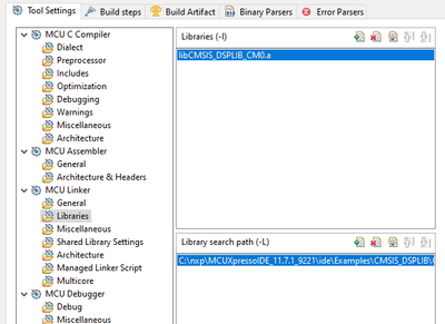

In settings I have these libraries in the new project by default:
And no libraries or lib search paths. So adding:
- libCMSIS_DSPLIB_CM0.a
- C:\nxp\MCUXpressoIDE_11.7.1_9221\ide\Examples\CMSIS_DSPLIB\CMSIS_DSPLIB_Latest\CMSIS_DSPLIB_CM0
Doesn't successfully compile:
I'm pulling my hair out. Please help before I am bald!! Thanks, Brent.

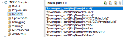

Hello @brentsinger
You can refer to "Using CMSIS-DSP with MCUXpresso SDK and IDE":
https://community.nxp.com/t5/MCUXpresso-General-Knowledge/Using-CMSIS-DSP-with-MCUXpresso-SDK-and-ID...
Alice

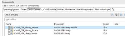

brentsinger
Thanks, This seems to be a move in the right direction...
But the SDK I generate doesn't actually have the /lib/libCMSIS_DSPLIB_CM0.a directory or file in it. Or the examples, even though I have selected CMSIS DSP Library in the SDK generation.
I think it's for an older IDE version and changes have been made since. I will try again with fresh eyes today.
Is there someone in the FAE team who might be able to quickly put a "Hello World" together for me with the libCMSIS_DSPLIB_CM0 library linked? My target is the 824MAX development board, archive and send it thru. I might even send you beer. Otherwise I'll keep trying...

frank_m
Senior Contributor III
This was the default case with another vendor's MCU I made a few DSPLib applications for.
The ARM DSPLib comes with sources, and examples. Just use the source files instead and include them into your project, perhaps take a DSPLib example as template.

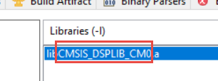

Hello @brentsinger
How change libCMSIS-DSPLIB_CM0.a to  CMSIS-DSPLIB_CM0 ?
Alice
3,490 Views
frank_m
Yes, that would be standard behavior for GCC.
The "lib" prefix and ".a" suffix are automatically added to every name specified with "-l<lib>".
Not sure what Eclipse/LPCXpresso adds to the mix.
I would try to add the library via Drag&Drop, and add the library folder to the search path list.
