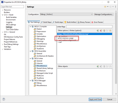

I'm using MCUxpresso IDE and I want to change the linker script so I'll be able to see the size of of my project in the my flash.
The issue is i can't edit the script no matter what I didn't succeed to delete it or change it.
Please anyone can advise what should I do.
Thanks in advance.

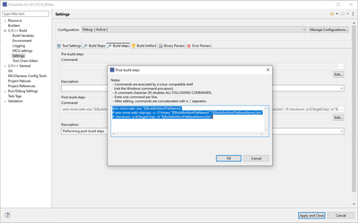

This is usually done with the GNU 'size' (https://mcuoneclipse.com/2014/05/04/printing-code-size-information-in-eclipse/ ) utility (see https://mcuoneclipse.com/2020/01/10/listing-code-and-data-size-for-all-files-with-the-gnu-size-utili...  ) and the MCUXpresso IDE has all the support for it.
Check your build steps:
Additionally there is a setting to print the memory usage here:
I hope this helps,
Erich

the size in your flash would be the size of the binary you're flashing in, not the elf.
