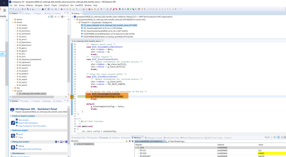

Hello Mike Spenard,
I test the demo on my side, it can hits   the case  of  "kI2C_SlaveCompletionEvent",
Try to set a breakpoint on line 67  g_SlaveCompletionFlag = true;  just like my picture above,  connect tow lpc54628 boards, flash mater project to Master board, download slave project to Slave board, click Run, then Reset Master board,
it should stop at the breakpoint.
BTW, please use the latest SDK v2.5.
Hope it helps,
Alice

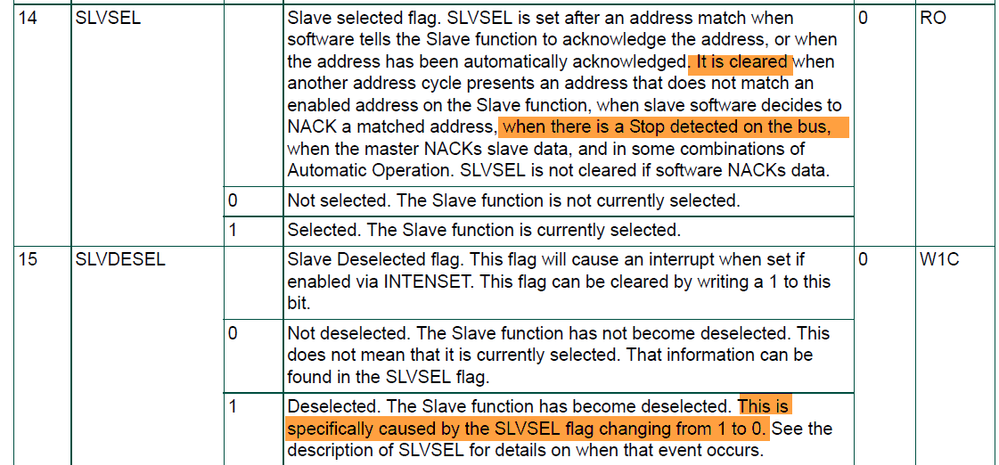

In digging into this further in the LPC546xx Reference Manual (https://studio.segger.com/packages/LPC54000/CMSIS/Documents/UM10912.pdf ) I can see what happened:
There is a set of registers (MONACTIVE et al) specifically for monitoring the I2C bus condition (start stop etc). But the FSL_I2C.C API failed to implement them in its code! Rather, they took the example from 26.4.2.1 for transferring 8bits--that doesn't use the monitor registers--and used the same transfer scheme for transferring multiple bytes of data as if that is acceptable in the real world.
Someone needs to update the fsl_i2c API asap, this is asinine.

Hello Mike,
- "And the API needs to be written such that it hits a Completion State on a I2C stop rather than rxData counting down to 0." - Yes, this demo just shows raData down to 0. If you want to hit a completion state on Stop,  just need to add the  "case kI2C_SlaveDeselectedEvent " in  i2c_slave_callback function, for example :
In i2c salve callback function:
static void i2c_slave_callback(I2C_Type *base, volatile i2c_slave_transfer_t *xfer, void *userData)
    switch (xfer->event)
        case kI2C_SlaveDeselectedEvent:
         //        Your own code
                   break;
And in transfer function. we need add kI2C_SlaveDeselectedEvent:
  /* Start accepting I2C transfers on the I2C slave peripheral */
    reVal = I2C_SlaveTransferNonBlocking(EXAMPLE_I2C_SLAVE, &g_s_handle,
                                         kI2C_SlaveAddressMatchEvent | kI2C_SlaveCompletionEvent|kI2C_SlaveDeselectedEvent);
- when Master send Stop, the Slave Deselected flag of STAT will set to 1 , then in the function of   I2C_SlaveTransferHandleIRQ invoke kI2C_SlaveDeselectedEvent .
Please check the driver code :
void I2C_SlaveTransferHandleIRQ(I2C_Type *base, i2c_slave_handle_t *handle)
    uint32_t i2cStatus = base->STAT;
    if (i2cStatus & I2C_STAT_SLVDESEL_MASK)
        I2C_SlaveInvokeEvent(base, handle, kI2C_SlaveDeselectedEvent);
        I2C_SlaveClearStatusFlags(base, I2C_STAT_SLVDESEL_MASK);
Also have a look at the LPC546xx Reference Manual page 445.
