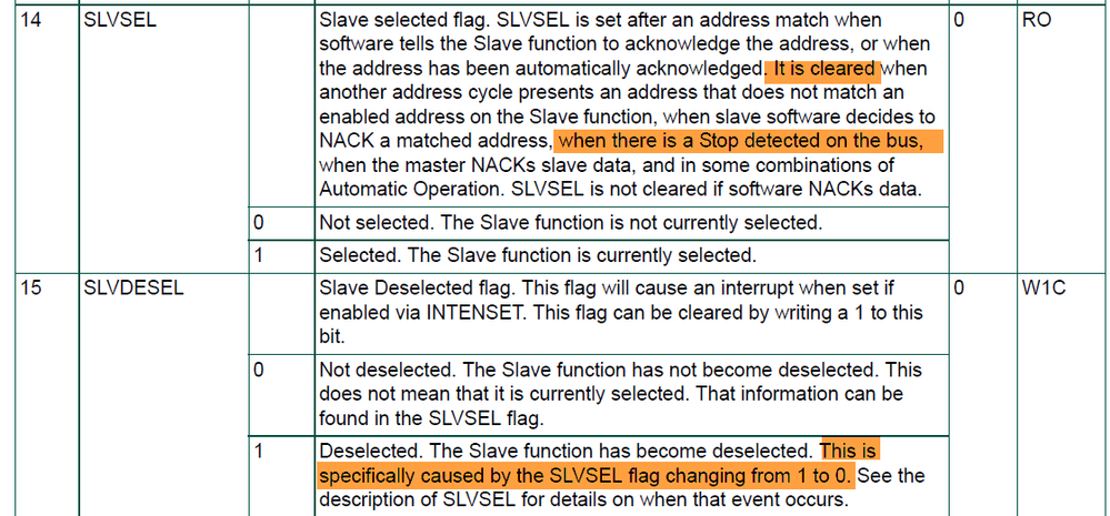

In digging into this further in the LPC546xx Reference Manual (https://studio.segger.com/packages/LPC54000/CMSIS/Documents/UM10912.pdf ) I can see what happened:
There is a set of registers (MONACTIVE et al) specifically for monitoring the I2C bus condition (start stop etc). But the FSL_I2C.C API failed to implement them in its code! Rather, they took the example from 26.4.2.1 for transferring 8bits--that doesn't use the monitor registers--and used the same transfer scheme for transferring multiple bytes of data as if that is acceptable in the real world.
Someone needs to update the fsl_i2c API asap, this is asinine.

Hello Mike,
- "And the API needs to be written such that it hits a Completion State on a I2C stop rather than rxData counting down to 0." - Yes, this demo just shows raData down to 0. If you want to hit a completion state on Stop,  just need to add the  "case kI2C_SlaveDeselectedEvent " in  i2c_slave_callback function, for example :
In i2c salve callback function:
static void i2c_slave_callback(I2C_Type *base, volatile i2c_slave_transfer_t *xfer, void *userData)
    switch (xfer->event)
        case kI2C_SlaveDeselectedEvent:
                   g_SlaveCompletionFlag = true;
         //        Your own code
                   break;
And in transfer function. we need add kI2C_SlaveDeselectedEvent:
  /* Start accepting I2C transfers on the I2C slave peripheral */
    reVal = I2C_SlaveTransferNonBlocking(EXAMPLE_I2C_SLAVE, &g_s_handle,
                                         kI2C_SlaveAddressMatchEvent | kI2C_SlaveCompletionEvent|kI2C_SlaveDeselectedEvent);
- when Master send Stop, the Slave Deselected flag of STAT will set to 1 , then in the function of   I2C_SlaveTransferHandleIRQ invoke kI2C_SlaveDeselectedEvent .
Please check the driver code :
void I2C_SlaveTransferHandleIRQ(I2C_Type *base, i2c_slave_handle_t *handle)
    uint32_t i2cStatus = base->STAT;
    if (i2cStatus & I2C_STAT_SLVDESEL_MASK)
        I2C_SlaveInvokeEvent(base, handle, kI2C_SlaveDeselectedEvent);
        I2C_SlaveClearStatusFlags(base, I2C_STAT_SLVDESEL_MASK);
Also have a look at the LPC546xx Reference Manual page 445.
