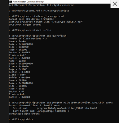

Dear Team,
We developed a application specific custom board using LPC4367 MCU and using LPCscrypt V2.1.1 to update the firmware. Boot select mode is USB0.
ISP mode is entered when P2.7 is low and press reset button. we can update the firmware using LPCscrypt.
When we try to enter ISP mode by calling  Chip_IAP_ReinvokeISP(); function, except "program" command all command will work.
Please find the below calling function for your reference.

Dear Pavel,
Thank you for your response and sorry for the confusion.
Yes, what you understood is correct.
I am trying to upload the bin file with the ISP mode using LPCScrypt.
As you know, 2 methods to enter ISP mode.
1. pull P2.7 low and press reset button
2. using Chip_IAP_ReinvokeISP() function.
Using 1st method  can upload the bin file easily but in the  2nd method getting timeout error as posted image in previous thread.
But if we try below steps using 2nd method we can upload the bin file.
Hope you understand.
Chethan kumar
