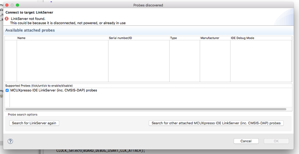

Could someone help me please with my board. When I attach it to my Mac I get the CRP DISABLD flash drive and MCUXpresso can't find the LinkServer. My other boards (LPC845-BRK and FRDM-KE15Z) work fine. I'm not holding the reset button down when I plug it in.
I seem to remember this happening a year ago, but forgot how to address it.
Please help!

Frotz
Hi Jeremy,
Thank you for responding so quickly.
There is no jumper on the board anywhere. It always mounts a drive called "CRP DISABLD" as shown in the attached picture (not the CRP_DISABLED drive the pdf suggests). MCUXpresso can't find the Link Server as shown in the attached screen shot.
I followed the directions in section 3.1 of the pdf you attached. There's no firmware at the link indicated in the pdf, so I used one I downloaded over a year ago. The procedure was unhelpful. Still the board mounts the "CRP DISABLD" drive, and the DAP cannot be found by MCUXpresso. This occurs whether the jumper is on JP3 or not. I tested the connection with an ohmmeter and found the connection open when the jumper is not present on JP3.

Frotz
Hi Jeremy,
That is in fact the exact same firmware I was working with in all my attempts.
I've only ever used this board on macOS. I've had problems in the past, but was always able to recover from them. All my other NXP boards presently work fine with the same Mac.
