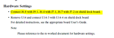

On the Read me documentation, i saw this hardware setting. Does this imply a jumper cable between J6-8 and J9-1? on the user guide that you posted, there is no reference of doing this.

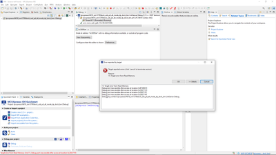

When I try to run the program on the IDE this is the message that i am getting
